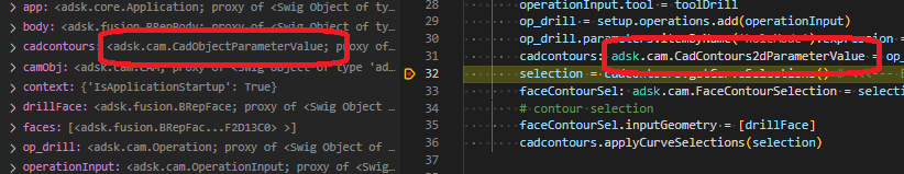

I create a drill operation and select my cylinder-Face as geometry (drill position),
but in the line "selection = cadcontours.getCurveSelections()" I get an error message:
"AttributeError: 'CadObjectParameterValue' object has no attribute 'getCurveSelections'"
Code:
# drillFace is my cylinder-face (I can select it manually in the operation)
operationInput = setup.operations.createInput('drill')
operationInput.tool = toolDrill
op_drill = setup.operations.add(operationInput
op_drill.parameters.itemByName('holeMode').expression = "'selection-faces'"
cadcontours: adsk.cam.CadContours2dParameterValue = op_drill.parameters.itemByName('holeFaces').value
selection = cadcontours.getCurveSelections() # <<<--- Error see below
faceContourSel: adsk.cam.FaceContourSelection = selection.createNewFaceContourSelection()
contour selection
faceContourSel.inputGeometry = [drillFace]
cadcontours.applyCurveSelections(selection)
# ERROR:
#selection = cadcontours.getCurveSelections()
#AttributeError: 'CadObjectParameterValue' object has no attribute 'getCurveSelections'
Best regards
Maurizio

kandennti
Hi @maurizio_manzi .
"op_drill.parameters.itemByName('holeFaces').value" is "CadObjectParameterValue" instead of "CadContours2dParameterValue".
Therefore, it must be done this way.
        op_drill = setup.operations.add(operationInput)
        # cadcontours: adsk.cam.CadContours2dParameterValue = op_drill.parameters.itemByName('holeFaces').value
        cadcontours: adsk.cam.CadObjectParameterValue = op_drill.parameters.itemByName('holeFaces').value
        # selection = cadcontours.getCurveSelections() # <<<--- Error see below
        # faceContourSel: adsk.cam.FaceContourSelection = selection.createNewFaceContourSelection()
        # contour selection
        # faceContourSel.inputGeometry = [drillFace]
        # cadcontours.applyCurveSelections(selection)
        cadcontours.value = [drillFace]

It should be a BRepFace listing, not a RevolveFeature.
        # drillFace = ext # Revolve as Face for drill operation
        drillFaces = [f for f in ext.bodies[0].faces]
        # cadcontours.value = [drillFace]
        cadcontours.value = drillFaces
There may be other causes, but we cannot be sure without seeing the data.

maurizio_manzi
It works fine, with:
 Thank you very much.
