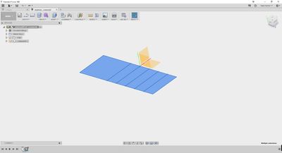

I'm trying to write a script where it would initiate an Input Command API to where it would allow me to select a profile. The selected profile is then extruded, using the command input API generated, to the desired input.
The script is a lot similar to the Extrude Command except it will be extruding stairs to the appropriate height.
I was able to write code that would generate the Input Command API but I can't seem to make anything extrude

I believe the main issue I'm facing is in "MyCommandInputChangedHandler" where correctly inputting the selected profile is "prof" in order to use it into the extrude.addSimple(prof,..)
Thank you

marshaltu
The root cause was "selInput.selection(0)" just returned a selection object instead of profile object. You have to call it like "selInput.selection(0).entity".
In addition, I would like to suggest you create extrude in command execute event handler, which is best practice. I modified the codes a little bit as below. Now it should work for you.
Marshal

the issue I am having now is that it will only extrude my first selection after giving an error
I'm posting the updated code and screenshots:

The problem was selection was cleared after the first extrude feature was created. You have to walk through all selections firstly and persist profiles before creating extrude features.
Please refer to the following codes.
