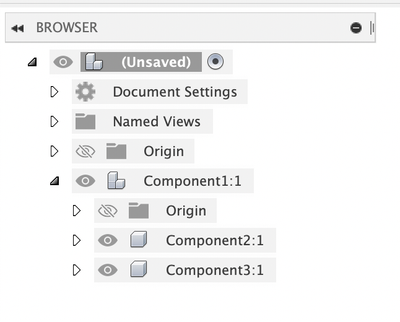

Thanks for following up @kanndenti.  I'm pretty confused by both of your messages, though.  I'll try to be clear about why, for each.
First confusion
In message 6 of this thread, you said "I feel that the reassignment of childOccurrenceProxy.transform2 is not allowed, as per the error message."  But I don't get an error when reassigning childOccurrenceProxy.transform2 (to be specific, line 33 of my script above does not throw an error) -- it appears to work correctly.  I didn't have a problem with this part, I was just demonstrating what I knew to work.
Second confusion
In message 7, you show an error from following steps in the GUI.  However, my script is trying to recreate steps I can do without error in the GUI.  Specifically, I follow these steps in a new document:
  • Create a new component (Component1)
  • With Component1 selected, create a second new component (Component2) as a child of Component1
  • Right click Component2 in the browser, and select "Copy"
  • Right click Component1 in the browser, and select "Paste New".  This creates a second child of Component1, called Component3.
When I follow these steps, the timeline for the document looks like this
and my browser looks like this
I'm confused about several things here:
  • what steps did you take to try to recreate my script?
  • where is the position feature in your timeline coming from?
  • since I can copy Component2 and "Paste New" to create Component3 in the GUI, and the documentation for addNewComponentCopy says 'This is the equivalent of copying and using the "Paste New" command in the user interface,' I feel I must be missing something to recreate the GUI interaction I just described.
Thanks again for your help and patience

@brent.hagany .
I was confused because I had tried so many things.
First confusion
The proxy was working correctly.
Second confusion
I was getting different results because I was trying a Matrix3D that I was moving around, like this
        mat: adsk.core.Matrix3D = adsk.core.Matrix3D.create()
        mat.translation = adsk.core.Vector3D.create(-1,-1,-1)
Indeed, when the same process was performed in the GUI, no warning was issued. I do not know why.
