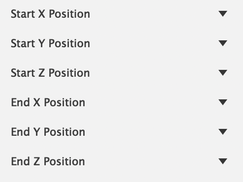

Edit field for valueCommandInput in command dialog box not showing up
I assume I'm missing something and it's not a bug since it doesn't seem like others are having this issue.
This is the code excerpt from my CommandCreated handler:
# Add value inputs to get the X, Y, and Z values for start and end point.
            startXValInput = inputs.addValueInput('startXValInput', 'Start X Position', design.unitsManager.defaultLengthUnits, adsk.core.ValueInput.createByReal(100))
            startYValInput = inputs.addValueInput('startYValInput', 'Start Y Position', design.unitsManager.defaultLengthUnits, adsk.core.ValueInput.createByReal(10))
            startZValInput = inputs.addValueInput('startZValInput', 'Start Z Position', design.unitsManager.defaultLengthUnits, adsk.core.ValueInput.createByReal(0))
            endXValInput = inputs.addValueInput('endXValInput', 'End X Position', design.unitsManager.defaultLengthUnits, adsk.core.ValueInput.createByReal(10))
            endYValInput = inputs.addValueInput('endYValInput', 'End Y Position', design.unitsManager.defaultLengthUnits, adsk.core.ValueInput.createByReal(0))
            endZValInput = inputs.addValueInput('endZValInput', 'End Z Position', design.unitsManager.defaultLengthUnits, adsk.core.ValueInput.createByReal(99))
the add-in yields a dialog box that looks like this:
with no field to type in number values like this (from the example SpurGear add-in):Screen Shot 2019-07-24 at 2.20.00 AM.png
I went over some example add-ins where it functioned correctly and can't seem to figure out what I'm missing.
Thank you for helping out a Fusion 360 API newbie!

If you move these registration of handlers at the end of notify function in PipeCommandCreatedEventHandler(adsk.core.CommandCreatedEventHandler), it will work. I need to investigate further why it is making difference but I hope it might help you to move further for now.
Shyam Goyal
Sr. Software Dev. Manager
I realized the issue is actually that if the name of the value command is too long and the dialog box too small, the name can "push" the edit field outside the dialog box where it can't be viewed or edited.
