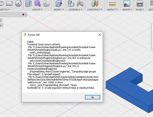

Hi there.
I tryed using this but only get a massiv error-message. Se picture.
You got any clue what can be wrong.
Message 13 of 17
DVE2000
Can you export that design and post it here? I couldn’t replicate the problem. This error was caused by just trying to show a dialog box and not with actually calculating or creating dogbones.

    I started getting this error after having the add-in working. I have no clue what is going on. I have tried and tried just making a simple 3 sided item with my tabs going into the 2 sides from the back. I may them down and I click on the add in and I get this. I exit, I get the dialog bog but can do nothing with it.
Please help.  Thanks for your time!!

The file containing the stored add-in variables has been corrupted.  The way around this, until we put in an error check into the next release of the add-in, is:
  1. Open file explorer and go to %AppData%\Roaming\Autodesk\Autodesk Fusion 360\API\AddIns\Dogbone
  2. If the directory contains a file called default.dat - please delete it and run Dogbone again.
Let me know if that has solved the problem, or if you need help to follow these steps.

Message 16 of 17
Thank you for your response. I am using this with MapBoard Pro and I thought there was some kind of conflict. It is working perfectly now and I have to say I look forward to any enhancements you make. While I love that this is free, you work is greatly appreciated and I would gladly be willing to pay for this or even donate. As a newbie, I have gone through the course and learned how to do the dogbones manually, but my current project has over 100 dogbones that need to be cut... and that would take so much time to get right... It just took me 3 minutes.
