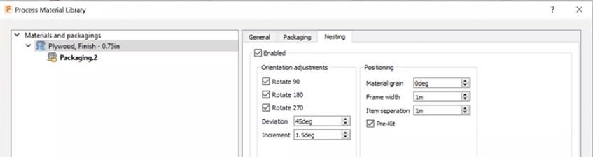

Can we open the following dialogs using API?
Similar to the Render Settings Dialog
Ptr<CommandDefinition> commandDefinition = commandDefinitions->itemById("A360RenderCommand");
commandDefinition->execute();
If yes, from where can we get the list of commands to open Fusion 360 dialogs?
561 Views
1 Reply
Reply (1)
boopathi.sivakumar
Hi @Anonymous
The commands are
MSFNestCreateStudyCmd
MSF.MAGMatLibraryCmd.FusionNesting
You can write a script to know all the executable commands
ui = app.userInterface
cmds = [cmd.id for cmd in ui.commandDefinitions]
print('\n'.join(cmds))
This should print all the command definition Id's
