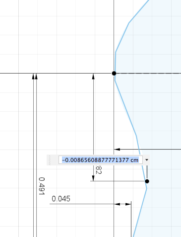

Ideally - negative horizontal and vertical constraints should just work the same as positive ones, just "going the other way"
Presently, this is accepted without an error:
rh=d.addDistanceDimension(nose, sp, myHorizontalDimensionOrientation, sp.geometry)
rh.parameter.expression='{} cm'.format(splinex[i]*scale) # This is negative
but the resulting constraint is being treated as an absolute value (dropping the negative sign), which obviously messes things up...

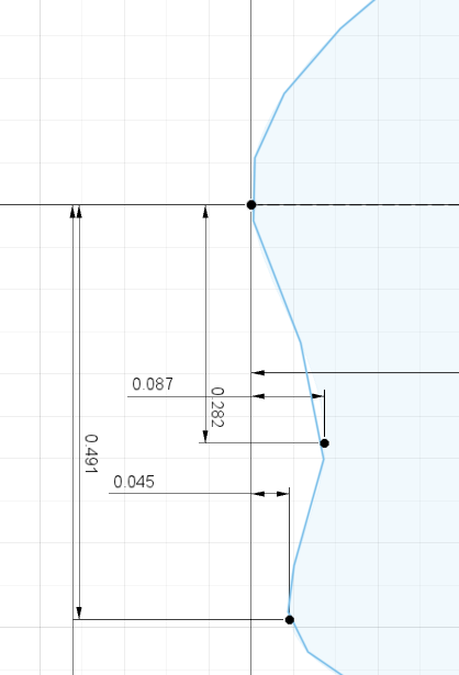

e.g. these look OK at first glance (except for the glaring fact that it's not supposed to have a dimple in it):-
The problem is revealed if you click on the one that's not supposed to be dimpled:
It's being treated like 0.087 when it's supposed to be -0.087
I notice it turns red if I try to change it.  It might be better to fix the code dealing with negative constraints, rather than try to hide that issue by trying to prevent users from entering them?

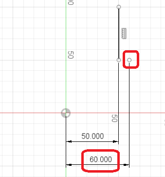

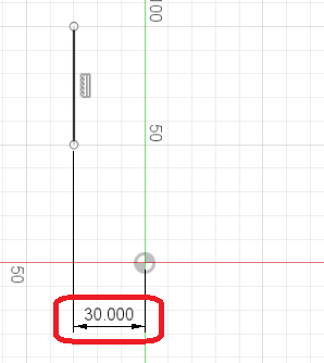

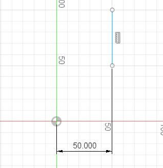

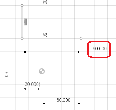

kandennti
Hi @OceanHydroAU .
I have some experience with macros in other CADs (CATIA), but other CADs do not accept negative values for sketch constraints.
Probably because it is for expressing distance, I think that it will only accept natural numbers.
Therefore, I feel that it cannot be called a Fusion360 bug.
I thought that it would be a problem as it is, so I made a sample as one idea.
https://github.com/kantoku-code/Fusion360_ChangeSketchDimensionValue
Please allow it though an error may appear because it has not been tested so much.
1. Make a sketch and make a constraint.
   Type should be "SketchLinearDimension".
2. Execute the linked script.
3. A dialog will appear. Please enter a number other than 0.
   Of course, you can use negative values.
It is a difficult process to understand, but it is done in this way.
I made the constraint non-driven, created points and constraints temporarily, moved them, and then brought them back in again.
Message 5 of 8
