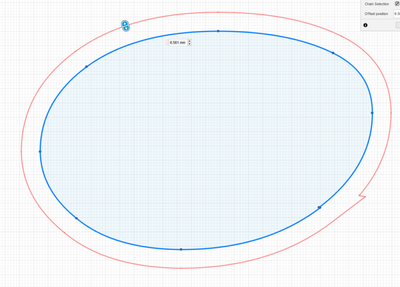

jiri.manak
I have a loop made of 8 SketchControlPointSplines. If I make a offset inside the loop, it creates open loop - which doesn't create profile to extrude. However it works fine if the offset is made in outside direction.
To reproduce the bug, use attached Loop.dxf and attached python script.  Changing the sign of the offset distance
(line 35) will create outside offset, which works.
Do you have any idea for a workaround?
Is it possible to close the loop within a script?
Jiri

Jorge_Jaramillo
Hi @jiri.manak ,
I was analyzing your DXF once loaded into Fusion and I found out that for some of the segments of the curve only one intersection curve is reported, and in only two cases the two adjacent curves are reported.
This is the snip I used for it:
    skt = root.sketches.itemByName(sketch_name)
    for curve in skt.sketchCurves:
        (ret, int_curves, int_points) = curve.intersections(None)
        app.log(f'{ret=} {len(int_curves)=} {len(int_points)=}')
Even though this, the curves do form a profile, which mean the curves are connected among them,  Very estrange this.
To try to solve the issue, I loaded the DXF file into illustrator and generate a new DXF file.
With this new file both internal and external offsets the profiles worked with your script.
I'm attaching the file in case you might need it (loop2.dxf).
Hope this help.

Jorge_Jaramillo
Hi @jiri.manak ,
These are the two points that make the lines not to be closed connected:
(14.954504256447025, 3.854850104428831, 0.0)
(14.95450537511926, 3.854850957190464, 0.0)
I tried adding a line between them like so:
    sk = sketches.item(0)
    sk.sketchCurves.sketchLines.addByTwoPoints(
        adsk.core.Point3D.create(14.954504256447025, 3.854850104428831, 0.0),
        adsk.core.Point3D.create(14.95450537511926, 3.854850957190464, 0.0))
and it closed the profile:
The distance between these two point is very tiny.
For me this is a BUG in Fusion360 which generates the two different points in the offset curve from the same point in the source curve.  I 'd checked the points in the source curve, and the points connect all the curves in the loop, otherwise it wont be selected as a profile.
Regards,
Jorge
