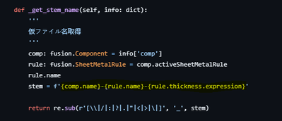

By naming convention, do you mean the name of the file to be exported?
Yes exactly. In my case i usually only name the part with the part name ( Body1-00061a-LEG-3_16-0_188IN would only be 00061a-LEG in my case). I export a BOM using Bommer that has all part name / materials / quantities
Message 26 of 36
cschofieldL2TXN
If you just want to change the name of the file that gets exported, I did this by opening SheetMetalExportFactry.py and FlatPatternExportFactry.py in VS Code and modifying the _get_stem_name function within the _get_path functions:
The highlighted portion is what you'll want to change if I understand correctly what you're after. This is what mine looks like now so that the file name is just 'bodyname.dxf' or 'componentname.dxf':
