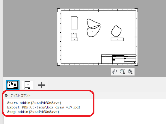

Each time you save, the exported log is written to a TextCommands window.
