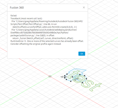

Can someone recommend an approach to creating an outline (offset) around every text character in a sketch?
Here's what I'm trying to do.  If I have sketched text like "test", I want to be able to create an outline around each character in "test".
So far my Python script explodes the sketch text, then I try looping through the profiles to create the offset for each character.  The first offset gets created correctly as you can see in the screenshot.  The problem is after that the profiles get recalculated automatically, which is messing things up.
Any suggestion on how to accomplish this?  I suspect I shouldn't be trying to do this through the profiles as they're constantly recalculated.
Here's the error:
My code:

You're right about the profiles being recalculated as the contents of the sketch change.  However, I think your code will work with a slight change.  You need two loops. The first will collect the geometry from the profiles before you start adding more geometry, and the second loops will create the offsets, using the collected geometry.
Without testing it, here's what I think might work.

snapper194
Thank you, that's working perfectly!
I tried something similar before, but I think I was trying to save the profiles in a list before I started modifying them, but for some reason that wasn't working.
BrianEkins
Saving the profiles won't work because, as you've seen they're being recomputed as new geometry is added, so the profiles you saved at first no longer exist as you start adding geometry.  This new approach saves the original sketch geometry, which isn't changing as you add new geometry, so it continues to work.
