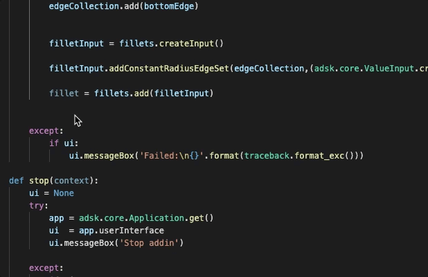

Ok. The second example is whats automatically comes up in visual studios if you start to type extrudes = ExtrudeFeatures (then a list of suggestions shows up, and if I click "ExtrudeFeatures" with an orange icon on the left of the text. The option replace "ExtrudeFeatures" with adsk.fusion.ExtrudeFeatures) same as I would use if I should cast ExtrudeFeatures.

I have attached a gif to show.
So when is it right to use this kind of path that vs code suggest in the gif?
BrianEkins
For me, code hints are primarily useful in two cases.
First, is when I know what I want and if it shows up in the list of code hints I can select it and save some time typing.
The second, and most useful, is when I have a known object type and it's showing me the methods and properties that object supports.  In this case, I think I know what I want but I may not be sure what the exact name is or I need a reminding of what's available.  Having a list to look through shows me what is supported and also saves me time typing.
An example is this. When I type the "." after "app" VS Code will show me all of the methods and properties that the Application object supports.  I can start to type userInterface and it will start to filter the list and I can choose it and insert it into my code.
app: adsk.core.Application = adsk.core.Application.get()
ui = app.
