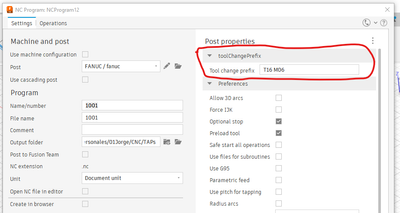

Please find attached the new version of the .CPS post processor file.
In the post processor dialog you will see a new option where you can set the tool change prefix instruction:
You can set it to any value you want or leave it empty to not to add the prefix instruction.

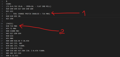

Then in the NC file you will get :
1) a comment in the header of the file with the configuration received by the post processor, in case you want to debug it.
2) the prefix instruction in the line before the change tool instruction
Hope this is what you were looking for.

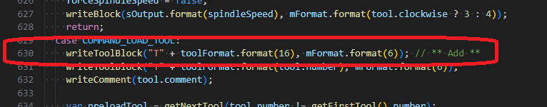

kandennti
Hi @dmilichnikov -San.
I have made the modifications and am attaching them.
The left is before the change and the right is after the change.
I added this line in the cps file.
Also, in consideration of what we talked about, we changed the default state of the "Preload tool" so that it is unchecked.
