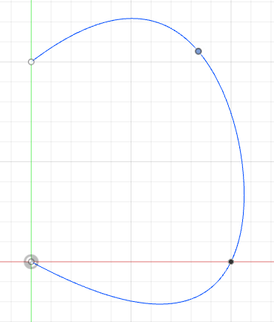

After having executed the script in Fusion 360, the spline looks like this:

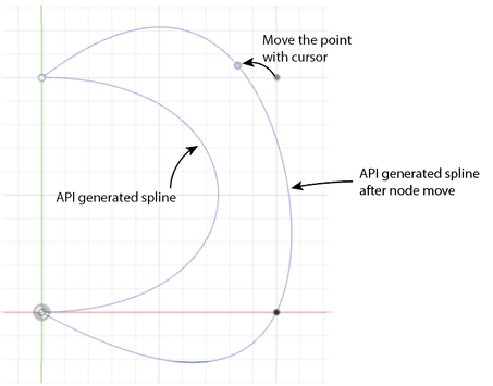

However, when I move any of the control points, the Nurbs curve is converted to a "Fit Point Spline", which transforms it to this:
So just to underline the change - here are the two overlaid:
What I want is the expected curve, which I've shown here: (Generated using the "Control Point Spline" command within Fusion):
Is there any way to create a spline through the API, which allows me to move the nodes without converting the curve to a "Fit Point Spline"?
