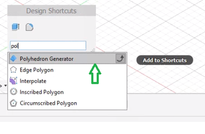

I am able to find it under Create drown down.
If the issue is just about missing the button. Then can you ask the user to use the Design shortcuts option to search for the command? To activate the Design shortcuts simply press S on the keyboard. If available, the user can add it to shortcuts as well.
