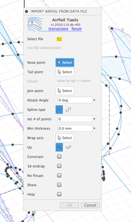

Hi @Anonymous - I'm still struggling with porting my solver, but it runs fin in Linux.  If you turn on your "text commands" window, you can see some useful information about the foil it inserts (best AoA and the L + D + L/D details for that).  Feel free to send me a copy of that text (right-click, select-all, copy) and I can send you back the data from my linux solver if you like.
I've almost finished coding the import and the export menu functions now - where "export" lets you select any airfoil shape to save to a .dat file, which you can then run through any airfoil program of your own (while you wait), plus I should be able to add a "cloud performance" option easily now, so I can use my linux solver to get you your data direct from the menu.
Remember to "vote" for the option you want the most - I do look at the number of users who have done that for prioritizing my effort!
(Previews:)
ExportExportImportImport

Yes, it does import and export - but you need the beta version for that - link is here: http://chrisdrake.com/Airfoil_Tools/  - I posted screenshots of this yesterday:  https://forums.autodesk.com/t5/fusion-360-design-validate/beta-testers-wanted-for-my-add-in-airfoil-...
Besides reading (and, optionally, automatically repairing) any kind of airfoil data file in any known format (or even just excel CSV), it also includes options to re-spline the input to your specifications, set minimum thicknesses, scale and join to your chosen location, rotate arbitrary amounts, flip it, add constraints, wrap it all around some axis (e.g. for rotating foils, like propellers), and insert elipses (useful for wingtips to have nice ends).  It even supports Degree-3 control-point-splines (probably nobody uses these except me, but they're essential for genetic optimisation because they resist looping).
It also does export too (thus, if you export anything, you can then do all the above when re-importing it!)
I'll be submitting this update to the production version after it undergoes more testing (I've done loads so far, and it all works, but needs checking on Windows - I use Mac mostly).
Import AirFoil .dat files using Airfoil Tools for Fusion360Import AirFoil .dat files using Airfoil Tools for Fusion360

Current version - it does not yet have a "thickness" specification for you (sorry!).
My back-end optimiser does have a "thickness" switch though, and I have processed a range of foils to produce an interim dataset with the following 12 thickness ratios:
0.05  0.1  0.15  0.2  0.25  0.3  0.4  0.5  0.6  0.7  0.8  0.9
(e.g. 5% to 90%)
... so what you're after is in my pipeline.
Meanwhile - I'm happy to whip some up for you - let me know the details (medium, speed, etc) and I'll generate some for you.  If you like - just create it in Airfoil Tools and give it a distinctive name, and click the "share" option, then tell me what that distinctive name was and I can find all the data in the logs.
My "import" option can be used to load files, so I'll send you some.
