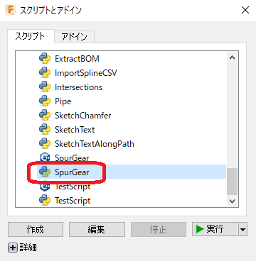

Attributes are stored in the document, but there should have been no way to see them in the GUI.
If I recall, the attributes are used in the script "SpurGear".
