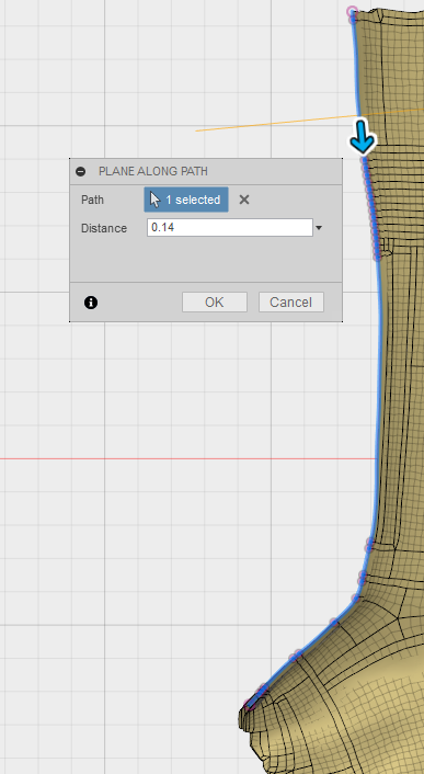

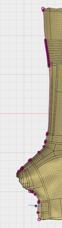

What I have currently done:
I have created an intersection between a Brep body and the XY plane (with the IntersectwithSketchPlane method), producing curves made up of fixed spline segments (picture attached).
What I want to do:
I want to construct planes tangent to each of these three intersections. I can do this in the UI; when I click "construct plane along path", the entire path is highlighted (pic attached), not just the individual fixed spline segments. How can I access this entire length programatically? Currently, all the individual lengths are saved as SketchFixedSpline Objects in a SketchEntity.
What I need:
I want to access all the fixed splines that are connected together as one spline, so that I can use it as a path in my next step. There hopefully should be an easier way than brute force reconstructing the spline using the StartPoint and EndPoint attributes of the SketchFixedSpline object. I have also attached my code.QuestionPic6.PNGQuestionPic7.PNG
