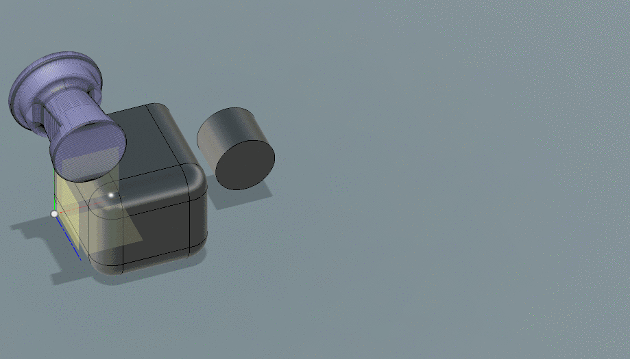

I am trying to develop a slicer for fusion 360, and I am struggling to find a solution for display.
When exploring webgl, it seems that any display operation in Fusion 360 destroys the webgl context in the palette.
Does anyone have some experience with webgl in a palette on mac?
Here is a movie, clicking on the "redraw button" should slightly rotate the sphere and redraw it:
hIfDFsa8CR
here is the HTML code in the palette:

nraynaud
upon further investigation, it seems that fusion 360 moves something about the camera in webgl (and it goes black because my background is black),
I tested by putting a scene containing an environmental map ( https://threejs.org/examples/webgl_materials_envmaps.html ) in the palette, and having fusion 360 do any drawing operation moves the point of view, or somehow destroys some matrix on the webgl stack but still "draws":
0J7MFhDuR8
