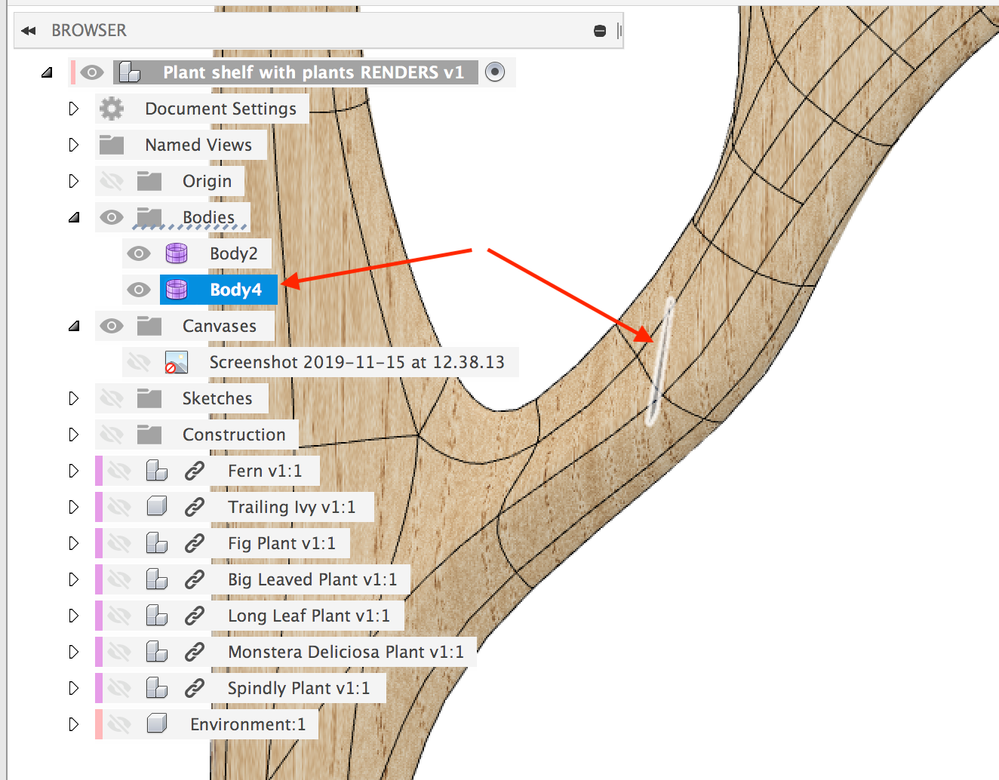

I noticed that there is a very tiny body in this model:
not sure if that is intentional or not.  I also don't think this is related to the crashes, just thought I would point it out.
I also understand, now, why the F3Z is so large:  All those mesh models of plants.  I understand that you want them in there for your rendering, but you might have a more pleasant experience if you rolled the design back before those designs are inserted, while you are working on the stand itself.
