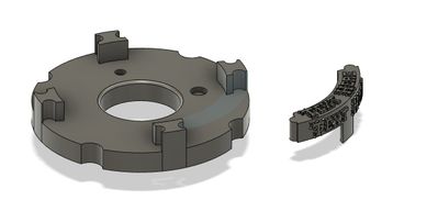

Ive been placing different text on this curved surface for ages and then extruding (its various text for a game). As you can see on the right hand piece
Now suddenly when I try to change the text the extrude fails and misses out a letter (letter W missing below)
and i get the error the extrude profile is not valid. if i change the text it works sometimes.

ive done the above screencast which shows it works for the number 3 but not the number 5..... and fails on the W

In all probability, this is caused by self-intersections of the contours during extrusion on curved objects.
Select the font and convert (explode) it to paths after right-clicking. Then you can see if there are such conflicting areas.
You can also share the f3d after doing explode.
