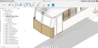

I have a drawing with loads on sheet metal parts and I need to create a drawing showing the bend lines.
This is the part I need, as you can see it is a sheet metal part:
