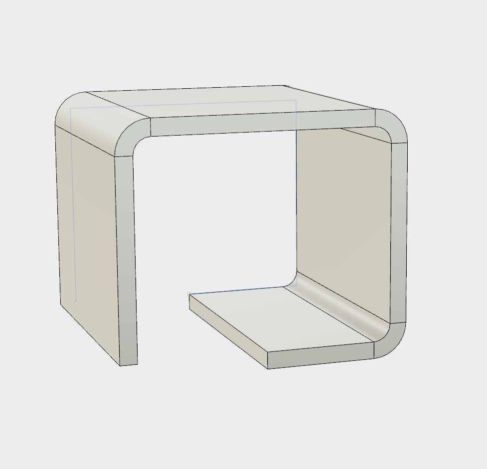

I don't know if you have this planned, but when I create a simple shape from a sketch like in the image I would like the possibility to change one of the bend radius individually.

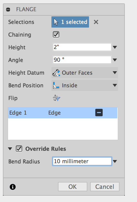

promm
@swicksell,
Inside the flange tool there is an override bend radius option at the bottom at the dialog.  In your example I would create the first two flanges and then override the third flange.
Please let me know your thoughts on this workflow.
