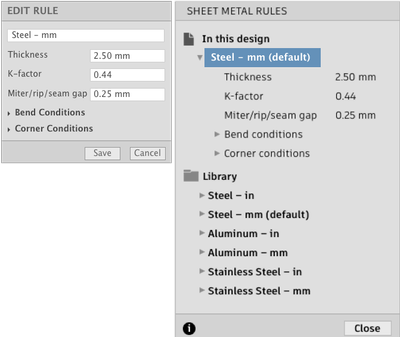

We also plan to improve the edit experience. When you edit a rule, an Edit Rule dialog is displayed next to the Sheet Metal Rules dialog. This is more consistent with the Appearance and Materials experience you may be used to. The Save button is also more discoverable in this dialog. And you’ll have a Cancel button if you want to discard your changes.
We hope this changes make it easier to create and define sheet metal rules. I’m always interested in your feedback on this or any of the sheet metal commands.
