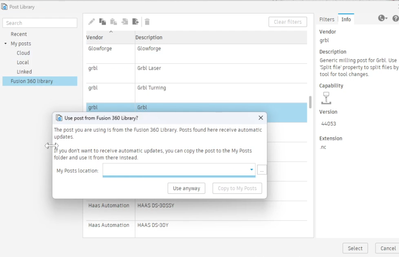

That file shows a new error
I think the root cause is somewhere here:
https://youtu.be/s8WhzvTyNjU
Message 10 of 14
seth.madore
At the 1:48 mark, you click "Use anyway". Please click on "Copy to My Posts" (once you've defined where that location is). Then, select the post from there, please

bw299105
Not trying to hijack this thread, but I am having the exact same issue with GRBL post. My failure in the post says:
"Error: The post configuration (.cps) requires revision 45917 or later of the post processor engine which has revision 45911.
You must either update your CAM package to the latest version to run this post configuration
or download an older version of the post configuration from https://cam.autodesk.com/hsmposts.
Failed while processing global script."
This may be the same issue youre having Rkeyqq

seth.madore
@bw299105 this is most likely telling you that you need to update Fusion. What version are you on? (current is 2.0.15509)

rkeyqq
Thanks a lot, that helped.
