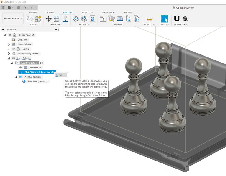

In order to improve the user experience, we have simplified the print setting selection/edit workflow to remove duplicated steps and streamline the process.
This has allowed us to tidy up the toolbar, and hence remove some icons:
Now, print setting selection will only happen from the setup dialog. Note, this is also the case with the machine and editing.
Once selected, temporary edits can be made to this print setting by clicking “edit” on the item in the setup itself:
Don’t worry, no print setting parameters have been removed, and they can still all be found within the ‘Print Settings Editor’ dialog.
If you want to make saved changes to a print setting (or create a new one) this can be done through the print setting library only.
