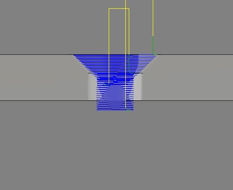

Created holes in design along with countersink...cut was well below where stock is.
Created bore in manufacture highlighted countersink and hole....simulation shows hole cut to model bottom...countersink good...
Played with heights either get no countersink or fail to generate tool path....what am i doing wrong

I used the method of boring a hole then bore the countersink with two operation....works but it feels like a work around...
So I created another bore with countersink and drill in same operation...worked but then i went to offset hole bottom to -2mm to drill through stock....nope got no toolpath because tool doesn't fit (it is a 1/8 ballnose in a 5.5 mm hole).
See attached file
Because you are using a Bore strategy the tool will only go to the ends of the Faces selected which is why you can`t get to the bottom with the Ball nose, the tool tip stops at the bottom of the hole.
To go through with the Ball nose you can only go to a depth past the hole bottom of a value that is equal to or less than the Radius of the Ball nose, in your case that would be Hole Bottom -1.6mm (To one decimal, = -1.5875 to four decimals, Radius of a 1/8 Ball nose), which is why your -2mm isn`t working, if you can live with the -1.6 then you are good to go 🙂 🙂 🙂

@engineguy, this isn't entirely accurate, if I'm understanding what I'm looking at in the file. With a -2mm offset, the Cone toolpath collapses into itself, which is why it works at -1.5, but not at -2mm. Here's the cone at a -1.5 offset:
Since the toolpath collapses, the entire selection fails, resulting in the warning you see.
Either split it up into two separate toolpaths, or live with the -1.5 offset and add material onto the bottom of the part to force the tool to go deeper

Anyway seems like you need to separate the operations first bore the countersink...then bore (because of odd size 5.5 mm)the hole with an offset of -2mm
This all seems reasonable since a countersunk hole is a really odd shape probably only gets used what 10 million times a year???? Geez
You totally can do both features in one toolpath, the issue is that your 2mm offset creates a toolpath that collapses on itself. If you had a bigger hole, or smaller tool, this issue wouldn't show itself
