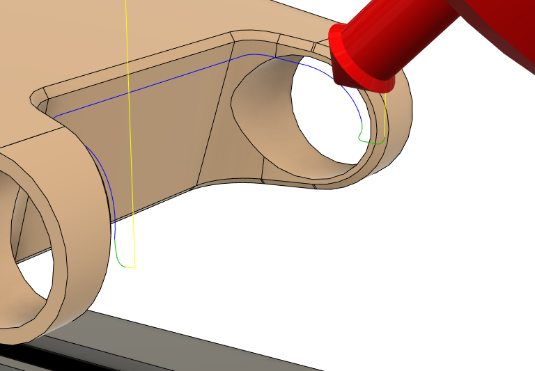

I'd like to chamfer some parts using our 5 axis machine. But somehow I can only get a 3D trace toolpath to work a bit. But then I can't reach tighter places.
Isnt there a 5 axis chamfer toolpath? Something like the following : https://www.youtube.com/watch?v=d1pRulUDWCE in Fusion360?
I somehow can't figure it out.
Thanks in advance

Hi @Paricla
I have not tried this with Fusion, but I think a Swarf may be able to do something like this.
You may need to construct some surfaces where you want to drive the tool though.
Here is a quick stab at it.......
Please don't mind the collision warnings 😊

Paricla
seems to work indeed!

I wonder if, using a ballmill, one could use multi-axis contour.  You'd have to remove the modeled chamfers and pick the sharp edges I think.  I might try that later because it could be handy at times.

Yeah, should work if you are trying to break edges.  You'd need to machine in negative thickness I'd imagine.  I use a similar toolpath in PowerMill for trimming.....same idea.

How did you construct these surfaces? Do you maybe have an example file for me?
