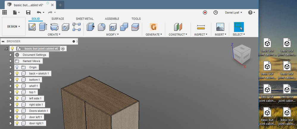

Do you wont to have one .stl per component or body if you select all the components by right-clicking at the top of the tree and selecting save as .stl?

daniel_lyall
@Patrick.B1 you cannot attach files to the idea station.
The second pick see the 2 rows of files 8 in total that is what I am asking if you want, the model the pick is from has 8 components 1 body per component.
A handy trick I got shown the other day is you can turn some of the components light bulbs off and right click at the top of the tree and select save as .stl this will send only the body's in the component that the light bulb is on out as .stl files this was from someone doing 2 material.

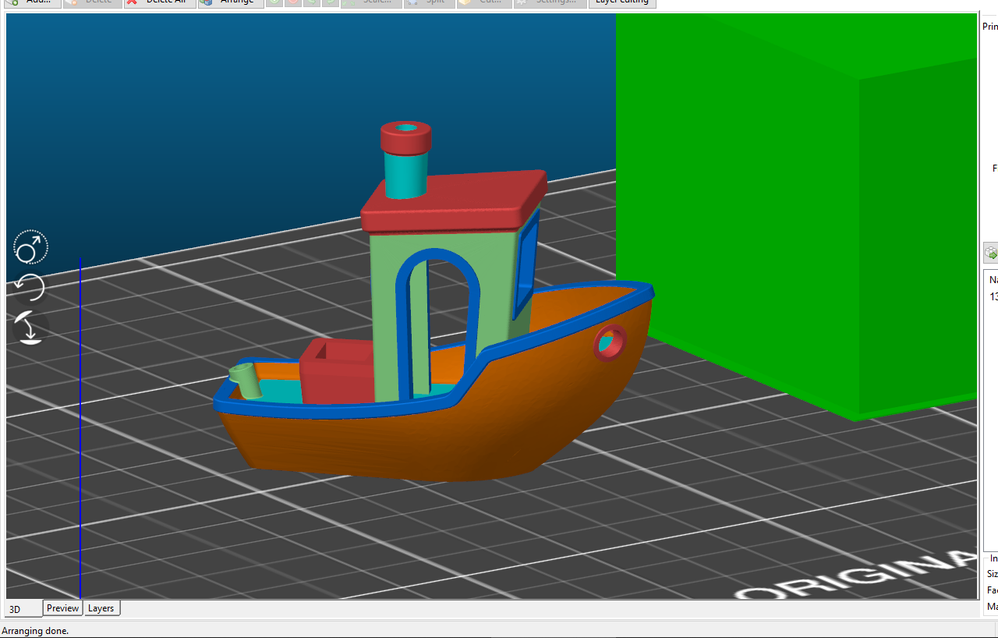

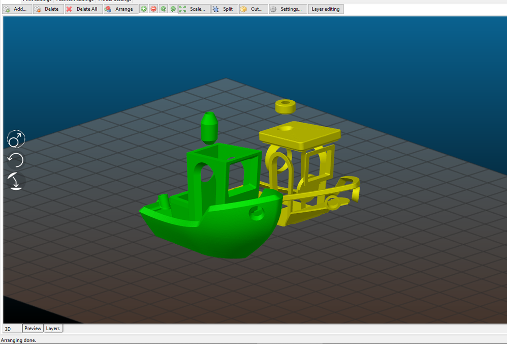

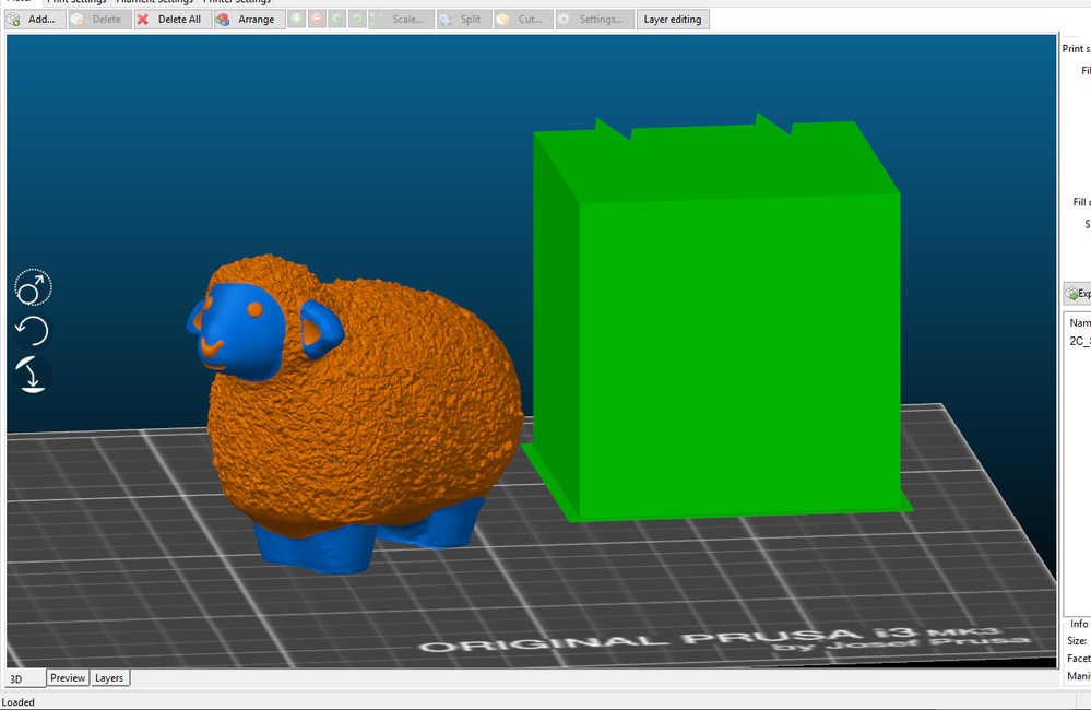

here i can post some pics for better idea
Also i just discover it's an .AMF files format . It's not possible in fusion but is there 1 export option that similar than .amf ?what i wish to have all STL in correct positionwhat i wish to have all STL in correct positionwhat i have !! 2 stl not correct positionwhat i have !! 2 stl not correct position
Patrick.B1
one more simple but only with STL Files this time !! so it's should work with STL only too ..import 1 STL fileimport 1 STL fileResult on SlicResult on SlicImport all files in onceImport all files in onceall files on right position with all colorall files on right position with all color
