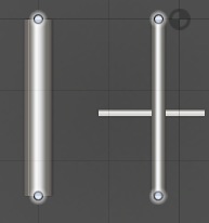

Ignore the Joint Origins in the screen shot, I'm not going to use them. Instead, I'll see how Fusion 360 could make this kind of construction clear, and intuitive to the user, as it already does in the Sketch side.
If I just start to move the blue (selected) bar, it's kind of difficult to even drag it near where it should be snapped. This is because I'm dragging in 3D and the "depth" of the drag dot seems not to be in my control. I end up with this:
The ends don't meet. The blue bar is behind the one I would like to snap it to.

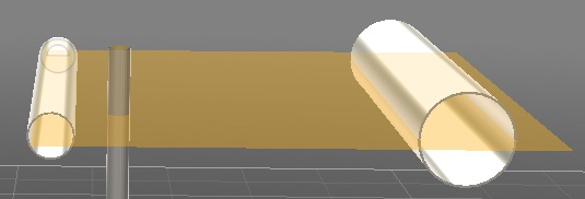

1. Let's create a work plane
Looking from above (right click on the sketch in Browser, 'Look at'), I place points on the sketch.
Now, if we can make the 3D elements be tied to these dots, that's (almost) it. We would in effect constrain the 3D model to always follow (changes in) the sketch.
