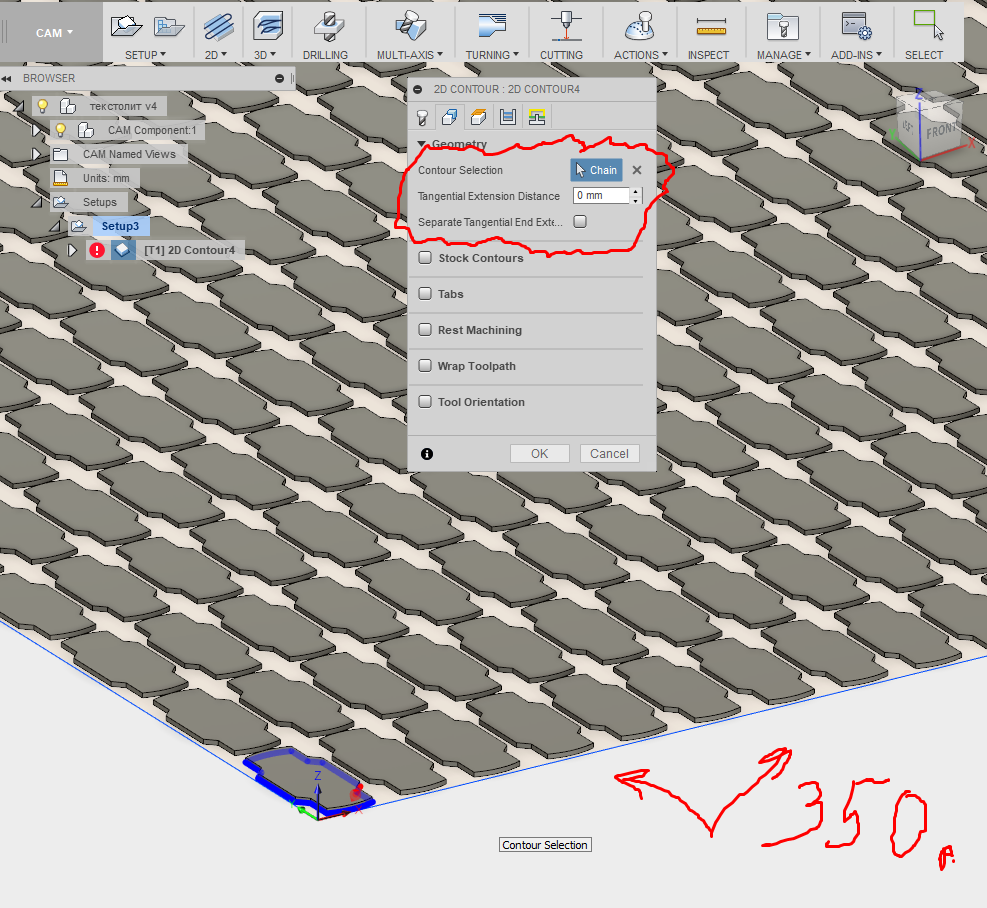

hallo, fusion
since last week I am just clicking and clicking working on this architectural model.. together about 20 thousand clicks only just to select  contours one by one by 2d contour or 2d engrave
please can you URGENTLY add functionality for multiple contour selection? 🙂

dear curtis,
yes but for this you need to prepare 3d model (include all the small lines (say 0,5mm width x 0,5 mm deep in my case) form the autocad file like on this picture below and use 3d pocket clearing (or adaptive clearing) operation for milling all the small lines (or like in your solidworks CAM sample video with Engrave operation)
also if you want to mill all the inside parts of the facade (all the inside triangle or rectangle shapes) would be better to mill only contours, not all the inside material..
so you need to select the contours in CAM operation (2d or 3d) - then again you have the same problem..
there is absolute need to be able to select multiple contours respectively chains by all operations.
at once (simultaneously), not only one by one.. thats it
and that's only one simple model.. there are sure more complex models  or shapes to come
many thanks
alex
