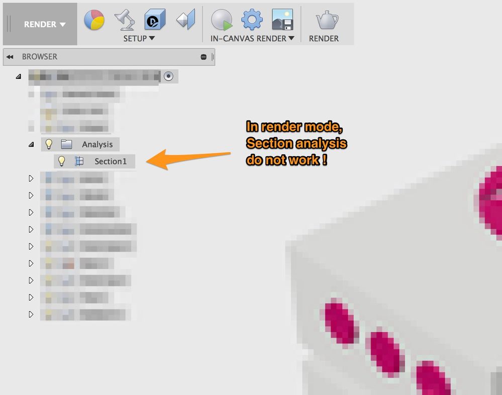

render-section-analysis.jpgCould you please make section analysis available in render mode ?
When we want to render the inside of an assembly, we have to cut through everything while we should be able to have section analysis available !
Com'on guys this is a simple one...
Please!!

@odolyte, actually it isn't that simple or we would have done it Smiley Wink
The section analysis tool uses clipping planes (and some magic) to make the sections.
In order to do a photoreal rendering we would need to make actual geometry.
We have this in our backlog, don't know the release date at the moment.
Colin

Couldn't a tiny script do the job as poor man's solution?  It would work like this:
  • gather and duplicate all visible things: bodies and meshes with current applied appearances into a new temp component (top level)
  • in this component, use the plane and direction of the active section analysis to cut each thing and discard, presumably this would be robust operation
  • make temp component visible and active and hide originals
This wouldn't make any hatching, though. The script should restore the original visibility when the temp component is deleted.
