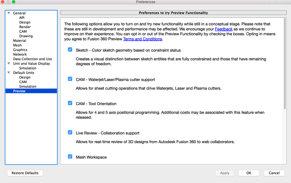

@Anonymous,
If you haven't turned on the preview for water jet/laser/router, please do.  You have two options for sending your designs to machines if you want more control over what is exported.  One option is to create the passes in CAM and export the G-Code to the machine and the other is to use the dxf export inside of CAM.
Regards,
Mike Prom
Mike,
I didn't know about turning on preview for water jet/laser/router. Very cool stuff.
Where do I export a DXF out of CAM?
Is there a way to pick all visible lines if I have a speaker grill it will take me all day to pick all the circles.
David
