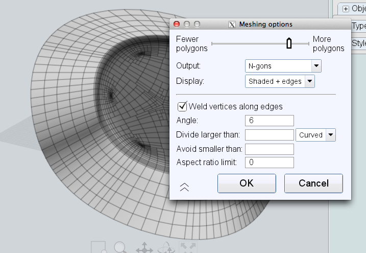

Fusions OBJ export only supports tries making it look more like an STL export.
For rendering this produces heavy meshes.
compare this with MOI which meshes with NGONs
Screen Shot 2014-05-23 at 12.00.06 PM.pngScreen Shot 2014-05-23 at 12.06.01 PM.png

Strongly believe this could be a really powerful feature if done right- MOI is the gold standard for meshing NURBs data, but is still limited by long triangles at the edges of patches. A lot of product rendering requires good UV mapping, and quad dominant meshes are essential for that- my pipeline is still: F360 export to .iges, MOI mesher to .obj ngons, Blender UV/render
Any product that can improve the meshing solution further would make a massive number of sales simply to studios that want to improve the meshing of their data.
I still dream of modelling solids, with all the tangency control of NURBs etc, and then having a mesher operate with the same fidelity as http://www.thefoundry.co.uk/products/modo/plugins/meshfusion/

NURBS to mesh I think is always a trade-off but MOI is pretty fantastic.
I also mesh based on how far an object is away, more refined meshing for close ups
corser meshing for objects more far away.

I am not using Fusion 360 polygon export at all. As said that's unusable and ignorant of our actual needs. So I completely rely on Moi for all of that. I am not advertising Moi but actually trying to raise your attention to the fact this app developed by just one developer fixed most of the problems I have encountered with Fusion.
