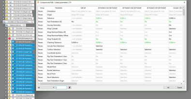

CAMWorks also keeps the direction of cut if you select the option "keep direction of cut"
I can't wait to see this on fusion 360 which is a software I love, meanwhile you can select all the paths you want to change, hit right click and select "compare and edit, which is the first option in the drop menu.
Whit that you can change from "climb" to conventional, and go around the system in an "easy way"
I hope this helps in the meantime, but please Fusion Team! put the option to keep the direction of cut in the operations that can apply.
Thank you
