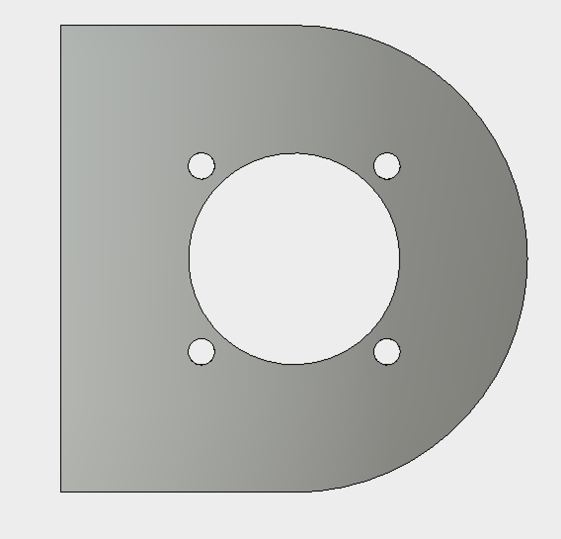

I would like the measure command to be able to find the mid point of any entity. In the attached image, I want to know what the distance of the part is from the base to the quadrant point of the arc. Right now when you select the base and the arc, it gives you the length to the center of the arc.

Not only midpoints but also center points for circles and broken circles, also the snapping should work in the Move tool as well. Right now let say I want to align a face to the center of a hole, there's no way to do that cause it'll snap to the edge of the hole unless I measure before hand the distance.

@kellings,
The new measure enhancements have provided a solution to your idea.  In the video below I show the tip where holding down command "Mac" or control "PC" will allow the face selection to stay active when picking points
http://autode.sk/1qKdIZG
