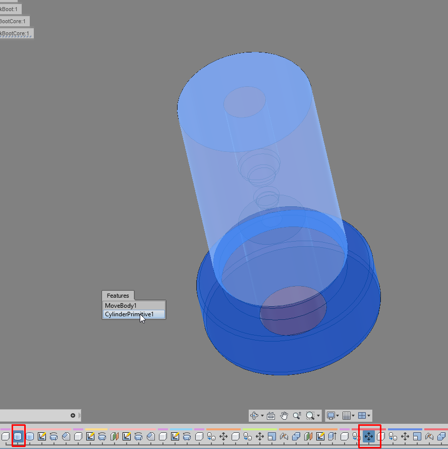

I would like to add "Find in Timeline" to the dropdown list when right clicking. I know that sometimes a series of hash-marks will appear above the feature when selected, but not if the body you are inquiring about has been paced into a component. I would like the feature to scroll across into view along the timeline.

If you click Edit Feature and you've moved a body into a component it will give you the option to edit the Copy\Move feature or the feature that created the surface.
Do you want to find the feature in the timeline to edit it or just to find where it was created?
Mark
I needed to find it in the timeline because I needed to delete the feature, and I couldn't find it easily in the timeline as it wasn't highlighted and was also so early in the model that it was scrolled off-screen.
