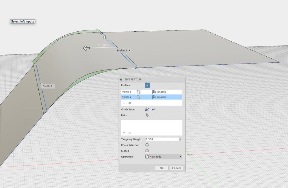

cekuhnen
@promm @jakefowler I think what @eric_strebel talks about is not the chord length but the ability to give weight options to the A and B side of a fillet.
This particularly is a must have for serious fillet work where I not just round and edge with a software predefined shape but sculpt that shape of the fillet aka secondary surface with more control.
Here I make a secondary surface with the loft command which for a blend surface gives you those weight tools.
Note the green surface being the G2 option for a fillet making it still look more like a G1 with a smoother start but maintaining
the flatter mid area.
