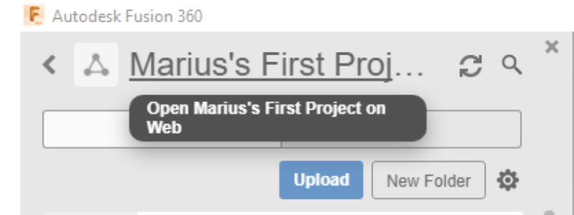

Hi Brad
Open it on the web.
Go to the file version you want to delete and open it.
Once open go to right side down arrow, click on it and delete the file.
Hope this works for you, it would be sad to see you drop this awesome package
