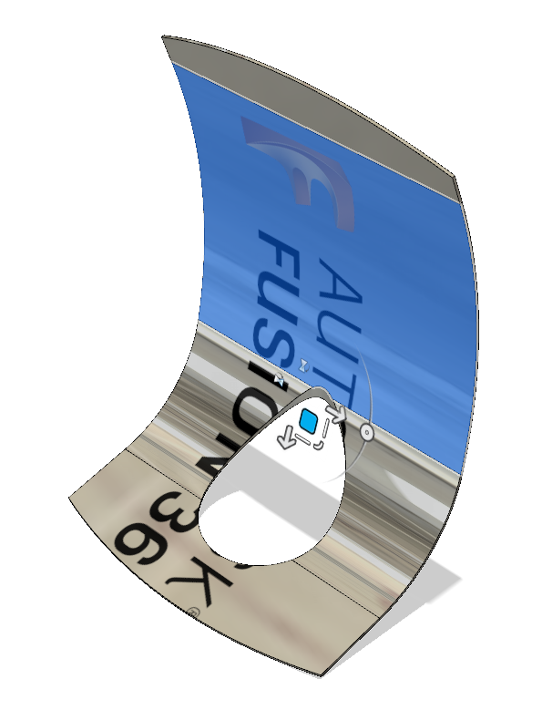

MariusBaard
Have you ever tried to place a decal over a hole. impossible, and it does not want to move past the hole edge.
Very fustrating

For a watch designer, being unable to place decals over holes is an absolute pain in the bum. Can't create bezels, dials, engravings etc without seriously long workarounds. Great package and one we're just starting to get in to, but this is already proving a big issue.
Can place decals over holes in Autodesk Showcase no problem so it's not like Autodesk don't know how to do it.
