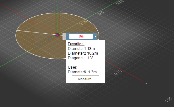

To make it more manageable for a project with a lot of parameters would be to confine the intellisense feature to only look at favorites or user generated.
And to add on further... a peek view of the expression/value/comment would help too.
