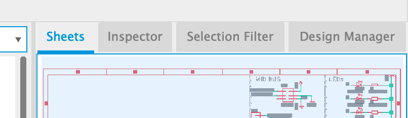

dps.lwk
@isedhe wrote:
• Cramming the inspector, design manager and selection filter boxes in one vertical column is useless as a default. I’m using a 27“ iMac and I’ve already changed UI scaling to get a little more space (running the HiDPI equivalent of 2880x1620) and it’s still way too crammed. Fortunately, those inspectors are tearable.
• The sheets pallet across the bottom of the screen is also not a useful default, as it steals vertical screen real estate. Those should go on the left edge by default.
• I can tear the sheets pallet off the bottom edge, but I cannot resize it nor dock it on the left or right edge.
• Resizing of pallet windows like the inspector is cumbersome, as you have to grab the lower right corner. Make all corners and edges draggable, please. Also, the draggable target zone is way too small.
Completely agree with all these
I just want to be able to tab stack them (sheets, inspector, design manager and selection filter) to one side just like I have them in EAGLE
This also applies to the 2D PCB view
Matt
