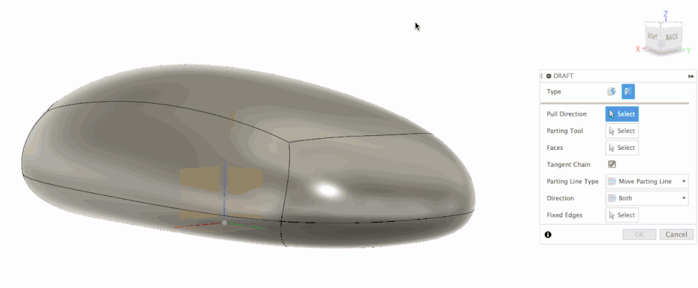

Glad to share that Parting Line Draft is now available with June 2020 release.
Rishabh Bisht
Product Owner
Message 11 of 16

rishabh.bisht
We have also added support for Move Parting Line Draft with our August 2020 Release.
Rishabh Bisht
Product Owner
