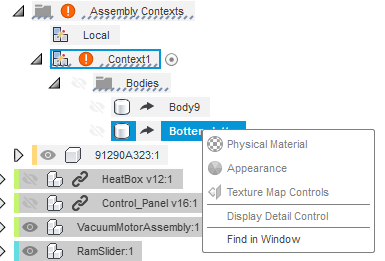

3) I really do not know what to do with the information displayed in the browser (se attached image). If there is an error (context broken)... now what? No valid option what to to with this. No highlight on WHAT the connection is between "Body 9" and.... I dunno, its gone. An option to "forget/delete/break" context would be nice. "Activate context" does not help since the reference is gone and no new options that allow to fix the issue appears. A continuation from my example: "Plane 2 (pin) needs Points 23, 24, 16 (bracket_rear) but are missing/lost": Create new from cache? or create new manually? or break connection (fix later, use cache with warning for now)?

  3. The image attached points to a broken Context feature.  A context feature, if not healthy, could be out of date with respect to the parent (blue icon on browser entry) or Broken (red icon on browser entry).  When broken, it means that the corresponding link in the assembly has been deleted.    You can right click on the Context entry and invoke the Delete command.  It will retain the referenced bodies and make them local to the XRef so that the features in the XRef that use those bodies will continue to work.

Assembly Context status confusion. An Assembly context can be Out of Sync (blue “i”) or broken (red “!”). What do these mean?
Out of sync (OOS) means reference geometries or positions have changed in the parent. This includes positions imposed on the subassembly’s children – even if those positions are not used in features created in that context. If you synchronize a context in the browser of the opened model, the cached references are updated from the latest context parent version and the model is recomputed to use these references. This does not cause the parent to consume the updated xref. That has to be done from the parent after saving the updated subassembly. You can also synchronize from the parent either via browser or the Context Feature in the timeline. They will both have the same blue icons. This synchronization will both update the xref and the parent in one step.
Broken means that the Assembly Context’s source/parent model has been lost. This can happen if information is deleted that connects the two models:
1. The xref link from parent to xref model has been deleted
2. The Context Feature in timeline of parent has been deleted or an old version has been promoted that does not have the feature
3. The parent model itself deleted

Florian__
The edit in place function is great. But there's one issue. If you edit a part in place and it is open parallel. Imagine we editing the part in place and afterwards, we close the parallel open part. Then it can happen, depending to the preferences, that the parallel opened part will autosave and the edit in place changes are overwritten. Would be great to get a message which changes you want to have. Or something like that.
Another thing would be quite useful that you can easily navigate to the location of the part threw the context menu or you can at least easily see its location path. A lot of time searching for the location of the included could be saved.  If that's not part of your work please forward it.
Message 40 of 50
gautham_kattethota
Hi Florian,
Great observation. Yes, with Edit In Place, users can easily get into situations where the part is open in its own tab, while the same part is being edited through Edit in Place through an assembly, in the same session.  We need to improve the user experience so that users do not unknowingly make changes in the part in both places.  We are looking into this.
Regarding your other observation, I guess you are asking for a better way to know which folder/project the contents of a distributed assembly (file with external references) came from?  If this is what you are reporting, then yes, I understand, that will be very useful to know.  I will forward it to the right team.
