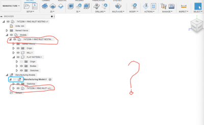

Message 13 of 61
@springai
When I click on Fit or Home, I still have the same problem.
Here's a screencast to show you the issue.
-Skiold

Hi Skiold,
I noticed that the eye icon of the Manufacturing Models node is disabled from your screencast, which means you have hidden the Working Models, that is why nothing to be shown in the graphics window. Could you please click on the eye icon to show the Working Models? This should show the models back. Let me know if it is not the case.
-Spring

David-Truyens
@Anonymous, I had the same issue, but I didn't realize that I need to activate the "Manufacturing Model" preview.
There's a great movie by Portland CNC. This is the first time I had to watch a movie to get something running in Fusion, so I guess one of the comments above about not being easy to use is valid, although I fully understand the reasoning now. But if you make the command easier to find and then pop up a box with "no valid manufacturing model, click here to get started.." would be nice.
I hope the real nesting tool will use the same tech and not the old TruNest (way too slow and clumsy), this one looks a lot better!!
