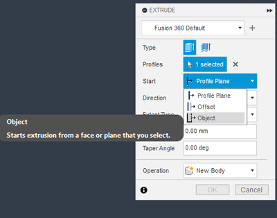

One thing to note from the description of what you were trying to do is you could have left the sketch where it was and used Start and set an offset.
