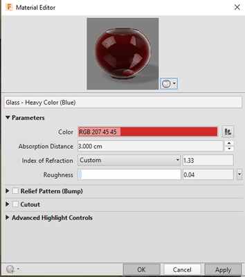

I also changed the material of the liquid to a glass material, but then changed the glass material. I changed the IOR to 1.33, the absorption color to  red and the  absorption distance to 3 cm.
