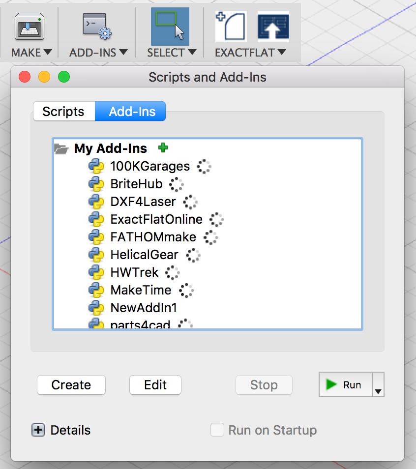

Please check if your addin is in the list in "Scripts and Add-ins" dialog. If yes, you can select your addin and "run" it in case it doesn't run yet. Otherwise, you can reinstall your addin and see if it solves the issue?
In addition, it would be great if you can tell me where you download the addin? Then I can give a try in my machine.
Marshal
