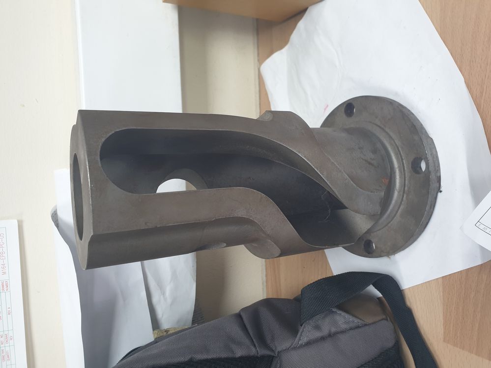

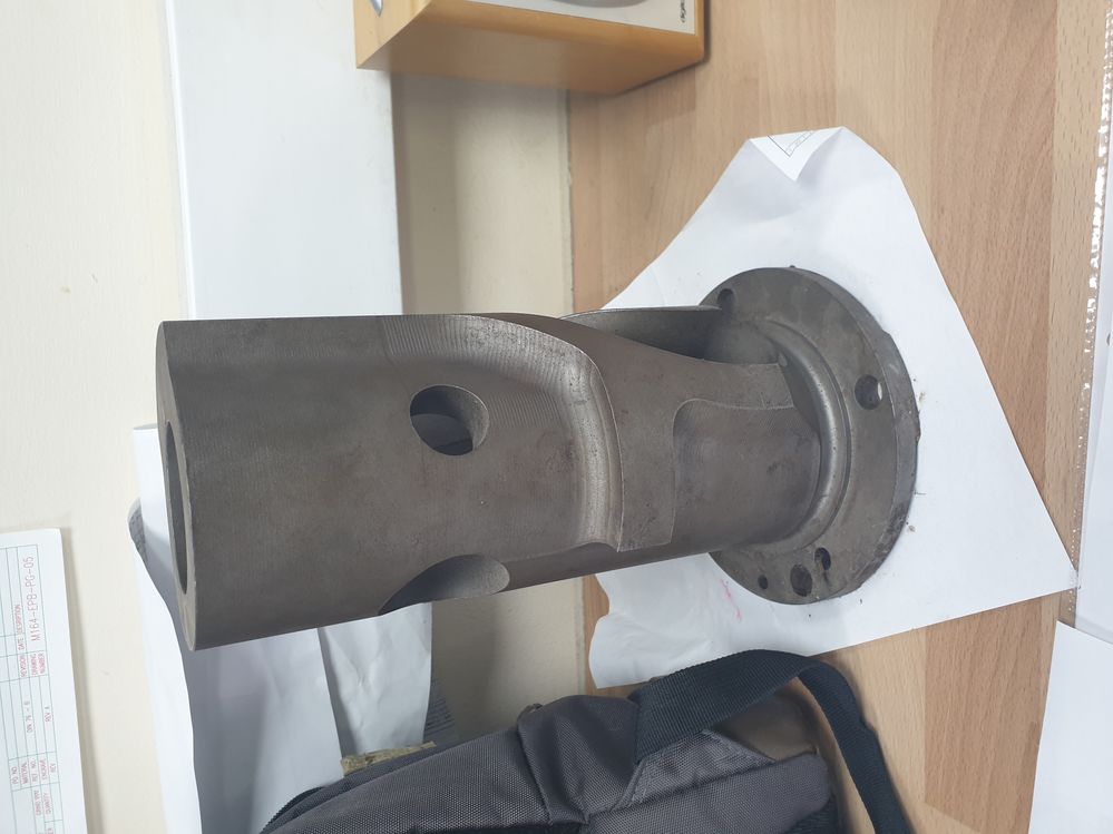

Hi
I'm new to using fusion so any help would be appreciated.
I am trying to create a solid model from wrapped geometry and am struggl20190816_100534.jpg

Cheers once again. The most important part is the slot. There is a rigid vertical pin that remains on the centre line. Its 38mm diameter and must run the whole length of the slot. I think the outer parts are just for strength. They are probably cast in the original part.
Regards Eddy.

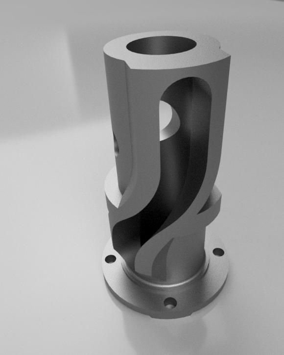

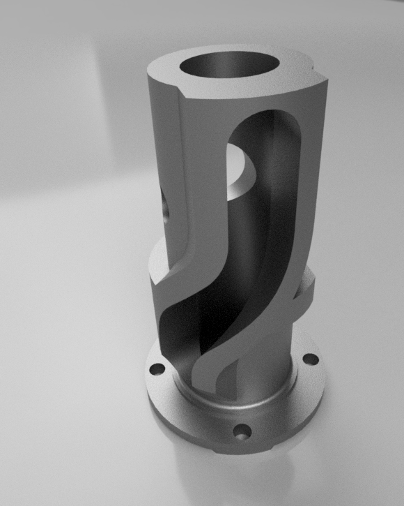

This time is a correct way of making such part:
Done with great inspiration from Konstantin
File in attachments.

I have managed to install fusion on my laptop and yes you have created a perfect component
as per the sample we received. If you have any spare time I would love to see the stages you used to
create this component. I have used the playback feature on fusion to see some of the steps. As I am sure it would benefit myself and other users in the future. Many thanks to you and your colleague who provided assistance to you. Hopefully I can return the favor to other members of this forum as my knowledge increases.
