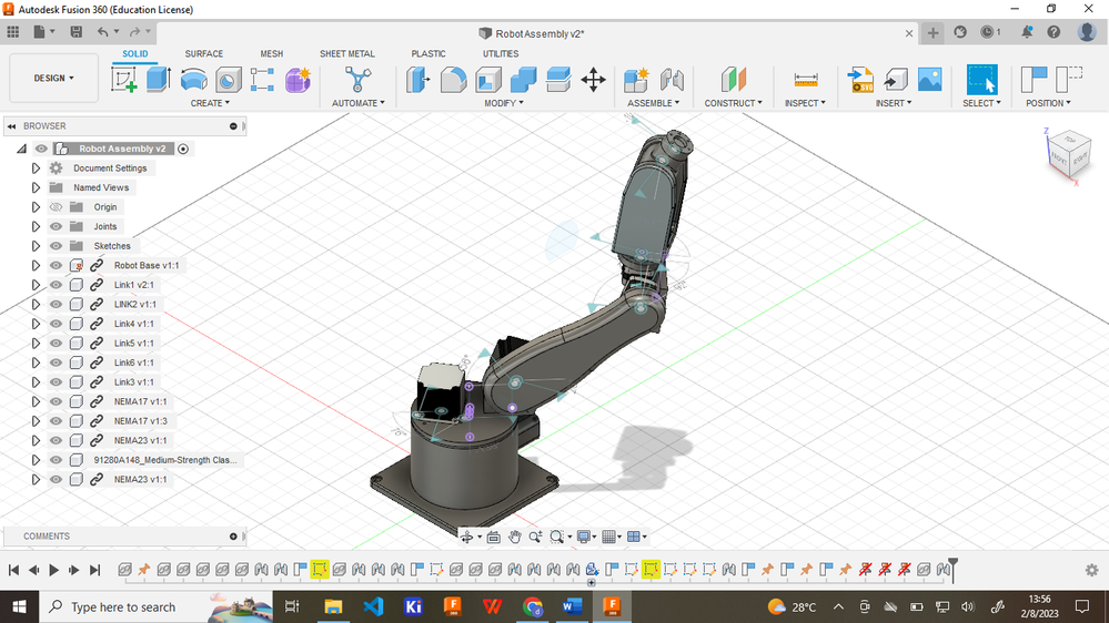

I have completed a robot project while taking a course on Design using Fusion 360. It's awesome for the accomplishment. Screenshot (141).pngScreenshot (144).pngScreenshot (145).png

TrippyLighting
Congratulations!
If you are looking to further improve your Fusion 360 skills, then please share the model. I can see some potential for improvement in the timeline of the screenshots you provided 😉

TrippyLighting
Again, congratulations. For a first design this is well done!
All sketches are simple, properly dimensioned and constrained.
All the parts in your assembly file are properly joined.
  • The position capture features are not needed and you should delete them. In more complex designs those will hinder performance
  • There are a number of ground/unground features. You have correctly grounded the base so the others are not needed and should be deleted. Remember, nice and clean timelines usually perform much better.
  • There are 2 yellow icons in your timeline, which are sketches. You should never ignore yellow or red icons. Fix these warnings/errors as soon as they occur. In this case the sketches ( in the assembly file) don't serve any apparent functions and can be deleted.
dishan_otieno19
Thank you for the response @TrippyLighting. I will make the changes.
